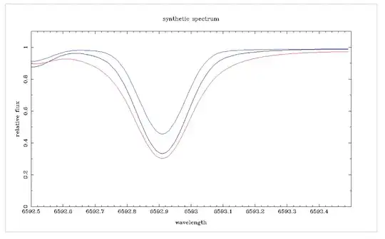

Here you can see the effect of various temperature values on the synthetic spectral line of FE I 6593 A. Red: $T_{eff}$ = 4000K; Black: $T_{eff}$ = 5217K; Blue: $T_{eff}$ = 6000K;
Effect of <span class=$T_{eff}$ on spectral lines" />
