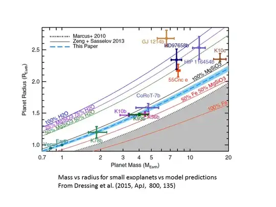

The observational determination of the chemical abundances in exoplanets is in its infancy. In terms of terrestrial type planets, i.e. those of size less than a few Earth radii, the constraints are confined to comparing the measured densities (obtained from the masses and radii of transiting planets found by Kepler and CoRoT) with models of what planets with certain assumed composition would look like. An excellent recent example of this can be found in Dressing et al. (2015). In this paper they make the claim that all of the low-mass planets are consistent with a single, simple 2-component models (a mixture of 83% MgSiO$_3$ and 17% iron, but that this changes at higher masses, where more volatile elements or significant water are needed to explain their lower densities. The plot below, taken from that paper, illustrates the available data and should be quite up-to-date. Note how all the low-mass planets (and the Earth and Venus) can lie on the same family of models.
Planet mass vs radius from Dressing et al. (2015)
I don't think that the authors are claiming that this is exactly what all the planets are made of, but simply illustrating that at present there do not seem to be any large deviations from such a composition (for example, planets that are made solely of iron).
There are relatively few planets on this diagram, because it is difficult to obtain the masses of small transiting planets (it requires detection of the doppler shift caused by the pull of the planet on its host star).
Of course different models yield somewhat different results. For instance, Wagner et al. (2012) used the same data for Kepler-10b and CoRoT-7b and their own detailed models to argue that these planets have an iron core that makes up about 60% of the planet - i.e. a lot more than makes up the Earth.
At the moment the data for the lowest mass planets currently indicate that there could only be a limited amount of diversity. But the information that we are working with, the sample size, and the fact that only masses and radii are determined, is too sparse to be sure.

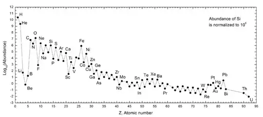

You may have a hard time finding definitive answers to these questions. I'm after the same answers and hope this will contribute as a starting point to something more specific and comprehensive .
Generally the abundance of elements appears to be closely related to their mass. In effect the heavier the element the more scarce it will be. This is due to the greatly increasing amount of energy needed for the fusion process to occur as you progress towards the heavier elements in the periodic table.
Elements heavier than Fe (Iron) are said to require an event such as a supernova explosion to form (or an environment with similar temperatures), which would occur once the star burns through its silicon fuel and collapses generating enough energy for the subsequent fusion reactions.
This video describes the process
Without going into compositions of elements you could probably start with the relative abundance of individual elements to determine the odds of them existing on any given planet and from there get into the forms/chemical compositions they would form in the planet's crust and atmosphere.
This is a graph from wikipedia showing the relative abundance of elements based on spectroscopy (based on emission and absorption spectra of the elements) measurements.
Element abundance in the universe Also shown here

  • The plot is the current abundance of material in the ISM or Sun. The abundances in terrestrial planets are of course quite different (e.g. How much hydrogen is in the Earth's crust?) – ProfRob Apr 09 '15 at 08:50
    Also, elements heavier than iron are not just produced in supernovae. – ProfRob Apr 09 '15 at 08:52
  • Caveat to my comment above - there is of course hydrogen in water - but there is less hydrogen than oxygen for instance in the Earth (and hardly any helium or other noble gases). – ProfRob Apr 09 '15 at 13:43
  • The graph is supposed to cover general abundance not just crust so majority is probably atmosphere content. I see how this may look a bit confusing in context of the question. How are elements heavier than iron created outside of supernova explosions? It has to be still nuclear fusion? – Marcin Apr 09 '15 at 16:33
    The plot is of the elemental abundances in the solar system (or in the Sun, since it dominates the mass). It is not the abundancs in the Earth, or terrestrial planets, which looks quite different for some elements, as I outline in my answer. Roughly 50% of the elements heavier than iron are made in (non-explosive) s-processes inside giant stars. - but you are not the first to make that mistake - http://physics.stackexchange.com/questions/7131/origin-of-elements-heavier-than-iron-fe – ProfRob Apr 09 '15 at 16:55
  • That makes sense. I can't believe the physics answer sat uncontested for 3 years. Does that basically mean that the temperature just has to be high enough for the heavy elements to form? – Marcin Apr 09 '15 at 19:33
  • Its not really (or solely) an issue of temperature. The s-process requires a neutron source. Wikipedia has the relevant details and seems OK. – ProfRob Apr 09 '15 at 22:06
