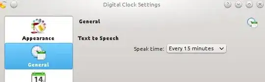

If I right-click on the clock in Kubuntu 14.04, then Digital Clock Settings, then General, there is a nice option there where you can choose the interval, and then the clock is supposed to speak the time aloud. I choose "Speak time:every 15 minutes".
Nice, eh? Well, I wonder why that is there, because it doesn't work.

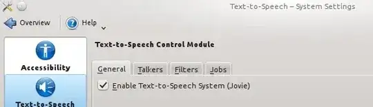

Then I activate "Enable text-to-speech" in System Settings - Accessibility. Yeah, very nice, but next time I reboot, it is deactivated and I have to activate it again.
