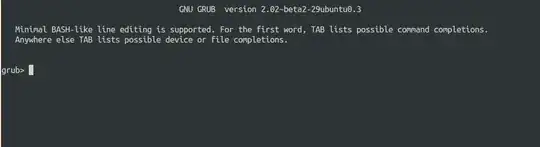

I don't have /boot/grub/grub.cfg present (or older /boot/grub/menu.lst)
It was impossible to install a boot loader during grub configuration:
https://i.stack.imgur.com/IBEiQ.jpg
Grub failed to install on the available options (/dev/sda /dev/sdb or /dev/md2)
md1 wasn't given as an option, even though it is currently mounted at /boot :
