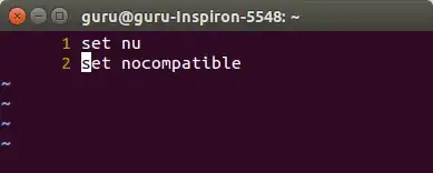

That is, the default width is 4, but 8 when in compatible mode. vi in default Ubuntu is vim.tiny, which doesn't support nocompatible, so the width became 8. You need to install vim to get the normal behaviour.
That said, if you do wish to set a different minimum width, say 2, just do:
set nuw=2
viorvim? Did you test after addingnocompatible? The docs say:'numberwidth' is reset to 8 when 'compatible' is set.– muru Oct 24 '15 at 06:54vi. Yes, I have tested it after addingset nocompatibleoption, as already shown in the screenshot. – Swaroop Oct 24 '15 at 06:57vim. No, your screenshot doesn't tell me that - for all I know you could have added it, and then taken the screenshot. – muru Oct 24 '15 at 06:58vim, I realized thatvimis not installed, so after installation of vim it works, with bothvias well asvim. But, what was the editor which got opened when I tried to previously open withvi? – Swaroop Oct 24 '15 at 07:03vim.tinya barebones version of Vim: http://askubuntu.com/a/434632/158442' – muru Oct 24 '15 at 07:04
