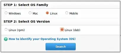

1) Open http://support.brother.com/g/b/downloadtop.aspx?c=us&lang=en&prod=dcpl2520dw_us_eu and select Linux and Linux(deb)
NOTE: I tried with Driver Install Tool with no luck :-(
