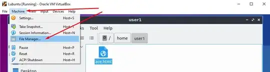

Copy and paste does work (provided you have installed VBoxGuestAdditions), but there is a few caveats:
  • There is text copy-and-paste and there is file copy-and-paste
  • If your VM is Windows, copy and paste should work for both text and file
  • If your VM is Ubuntu (or a flavor thereof, eg. Lubuntu)
    • text copy and paste should work
    • to copy files, you have to use the VirtualBox file manager...
To use File Manager...
  • In the VM window, choose file manager... open file manager
  • Log in using a linux user that exist on the VM to create a session log in to file manager
  • Then use the copy buttons copy between host and guest
