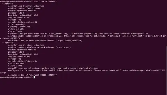

result of command "sudo lshw -C network"

  • sudo lshw -C network output,,
    description: Ethernet interface,,, product: AR8162 Fast Ethernet,, vendor: Qualcomm Atheros,, physical id: 0,, bus info: pci@0000:01:00.0,, logical name: eth0,, version: 08,, serial: xx,, size: 100Mbit/s, capabilities: pm pciexpress msi msix bus_master cap_list ethernet physical tp 10bt 10bt-fd 100bt 100bt-fd autonegotiation,, configuration: autonegotiation=on broadcast=yes driver=alx duplex=full ip=xx latency=0 link=yes multicast=yes port=twisted pair speed=100Mbit/s resources:
