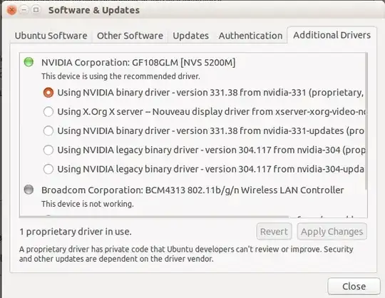

the safest way is to use the additional drivers that are provided by Ubuntu
in the dash write " additional drivers"
in my laptop i used the proprietary, tested and this is working fine
you may refer also to this topic for more info

I have the same issue on a notebook with a 540M (w/ Optimus). Using the proprietary drivers (tested or updates) in "Additional drivers" doesn't work. The only way to get to the unity greeter is to purge nvidia and use Nouveau.
https://bugs.launchpad.net/ubuntu/+source/nvidia-graphics-drivers-331/+bug/1310551
