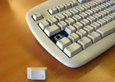

While researching your question, I also ran across this alternative solution:
Disable Caps Lock
