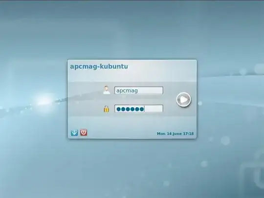

To select different DE, all you have to do is click on the little blue down arrow, and choose the DE that you want. See image below.

  • Ah, well, I will remember that! I didn't know that and didn't try it out. Thanks! Now that I think about it I kinda like the KDE login screen, it's nice – RPiAwesomeness May 31 '13 at 13:25
