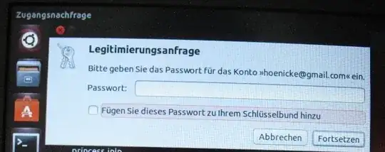

since upgrading to Ubuntu 13.04, I get a window asking for a password for my email address. The window appears after logging into the desktop. The window is titled "Zugangsanfrage" (access request) and "Legitimierungsanfrage" (legitimation request), asks for the password of the acount my email address, gives no further information and doesn't let me do anything until I enter a password or cancel the dialog. It has the option to store the password in the key ring, though. I can start new apps using the starter bar, but I cannot use them move windows, or type into other windows. I cannot even make a screenshot.
I have not even the slightest idea which password to give. Does it ask for my web-mail password or for the ubuntu-one password (where my login is the email address) or is it just a phishing app (but how did I get it). I tried entering some random characters and it is happy.
Update: I added a screenshot: screenshot

  • I've just asked in our chatroom and the quick consensus is this was a keyring window. The keyring stores your various identities and passwords in a secure location. If you've set up a password with truly random keys, you might want to reset the current keyring or you won't be able to unlock it in the future. – Oli May 01 '13 at 09:10
  • no the window gives no further information. The full text is: – joho May 01 '13 at 09:18
  • Legitimierungsanfrage: Bitte geben Sie das Password für das Konto "xyz@example.com" ein. Passwort: .... [] Fügen Sie das Passwort zum Schlüsselbund hinzu – joho May 01 '13 at 09:19
    it cannot be keyring, as it is asking if I want to store the password in the keyring (this wouldn't make sense, wouldn't it?) – joho May 01 '13 at 09:21
  • I do believe that that is the keyring: the checkbox asks if it can store it in the keyring. Now we can not see WHAT it is that asks this so... question: do you have a mail client installed on your system? Or do you use Ubuntu One? – Rinzwind May 01 '13 at 09:34
  • I have no mail client installed, but I use Ubuntu One. What is strange is that it does not matter whether I give a password or not. The Ubuntu One account seems to work (although I did not try to synchronize something). And it is really bad that the dialog does not identify the application that wants a password. – joho May 01 '13 at 09:47

The window comes from gcr-prompter and seems to be this bug:
https://bugs.launchpad.net/ubuntu/+source/gcr/+bug/1044549
I will try the workaround mentioned there (removing ~/.config/goa-1.0/accounts.conf)

It is the gnome-keyring gcr-prompter Window. You can find out using xprop (with a delay of 5 seconds to have enough time to bring the window in front)
sleep 5 && xprop |egrep 'PID|CLASS'
You will see something like
_NET_WM_PID(CARDINAL) = 14458
WM_CLASS(STRING) = "gcr-prompter", "Gcr-prompter"
So if you never used the keyring or forgot the password, you can simply delete your keyring folder (with backup):
mv ~/.local/share/keyrings/ ~/.local/share/keyrings.backup
mkdir ~/.local/share/keyrings/
Then Ubuntu will ask to set a new password the next time the Keyring will be used.
see also: How to recover/reset forgotten Gnome Keyring Password?
