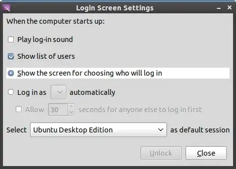

I would have expected System ▸ Administration ▸ Login Screen ▸ Play login sound to control this, but unchecking it does not prevent the drum beat sound from playing.

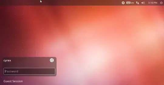

LightDM Way (works in Ubuntu Unity 22.10)
Also known as the FluteFlute Slap, the LightDM Way involves having to logout and on the LightDM Login Screen you can change the volume or even mute the sound.
In the Login Greeter you can see the Volume on the top right. Adjusting the volume there does not affect the volume when the session starts, so you can MUTE the sound in the Greeter without muting the sound when your session starts:

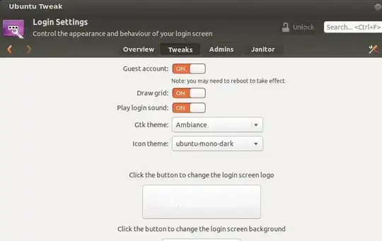

Ubuntu Tweak Way (not available in Ubuntu Unity 22.10)
The Ubuntu Tweak way involves having to download the Ubuntu Tweak app and then disabling the sound from there. Do the following steps and you can do it this way:
sudo add-apt-repository ppa:tualatrix/ppa
sudo apt-get update
sudo apt-get install ubuntu-tweak
Open Ubuntu Tweak and on the Tweak Tab select "Login Settings" option, you should see the Play Login Sound option. Yo need to click on the Lock button above to be able to change this.

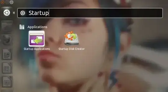

For Ubuntu 11.10 and Below
Go to System -> Preferences -> Startup Applications
Disable the one called GNOME Login Sound
(uncheck the box and click close)

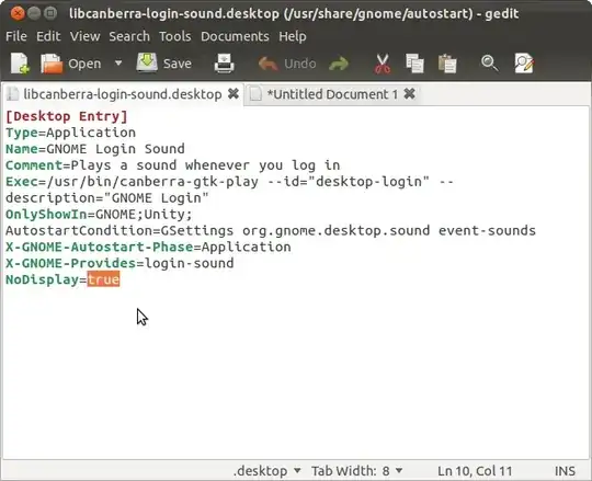

For 11.10
Type on a terminal gksudo gedit /usr/share/gnome/autostart/libcanberra-login-sound.desktop and change the value NoDisplay from true to false:
Now go to your startup applications and you should see and be able to disable the necessary option:

10.10 (GDM)
There appears to be a bug in the Login Screen about this. I can't find an official report, however, this forum post confirms a fix.
Go to System/Administration/Login Screen. Unlock it, then tick "Play login sound".
Close the window, then, go back into the app again, unlock it, then untick the same option.
