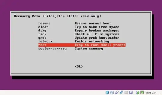

It definitely is not "supposed" to do that - but it happens.
Workaround: in the recovery menu just select Drop to root shell prompt enter image description here and inside try
sudo fdisk -l
to get a list of drives and partitions
mount
should give something like
/dev/sdb5 on / type ext4 (rw,errors=remount-ro)
and then with the partition you just found
sudo fsck -f /dev/sdb5
sudo mount /dev/sdb5 / -o remount,rw
fsck -f forces a check, even if there is no indication of a problem on the partition.
Now your root partition is error free and mounted (rw). You would now be able to do anything there with root permissions - so be careful!
