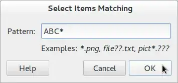

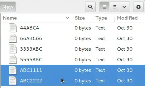

You can search for a particular pattern using the Nautilus file manager and regular expressions.
To do so, click on Select Items Matching in the Gear menu like below (you can also press Ctrl+s).
Then, just type the regular expression ABC* and validate.
Every file whose name matches your pattern will be automatically selected.
I'm using Nautilus 3.6.* from GNOME3 PPA on Ubuntu 12.10 (Quantal).
