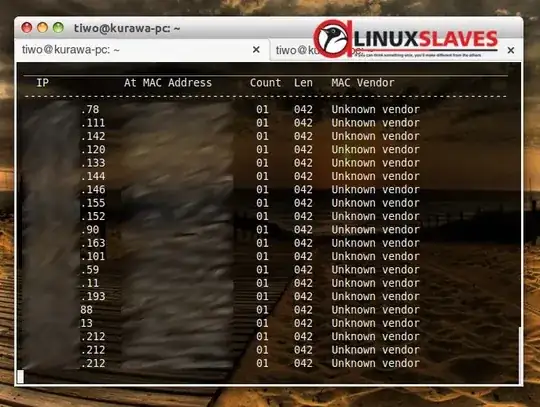

Netdiscover can be your answer.
To install via terminal:
sudo apt-get install netdiscover
example usage :
sudo netdiscover -r 192.168.1.0/24 -i wlan0
An IP with MAC Addreses will show on your terminal. See the screenshot
hope help you
