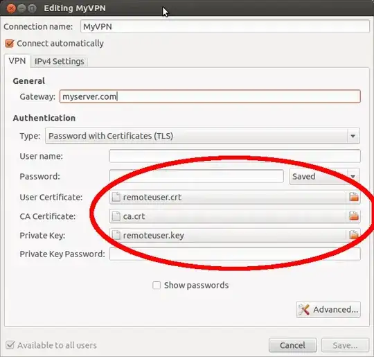

First, install the OpenVPN Network Manager plugin:
sudo apt-get install network-manager-openvpn-gnome
Open Network Manager, click "Add" and from the opened window select "Import a saved VPN configuration..." under "Choose a Connection Type". Navigate to your .ovpn file (~jrg/Documents/vpn-config.ovpn). If it doesn't automatically find your certificates/keys (the paths of which are found in the .ovpn file), you can select them here, or make any other small changes.

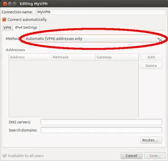

One other thing that may save you some headache down the road is to click IPv4 Settings, then change the method to "Automatic (VPN) Addresses Only". When kept at the default, this will cause ALL internet traffic to go over the VPN, regardless of your .ovpn settings. Here you can also set the DNS server and search domains to use while connected.

    It doesn't show the certificates and such when I click "Import". – jrg Sep 13 '12 at 22:35
  • I updated my answer to be a little more thorough. If the options just aren't showing up, than you either have a misconfigured .ovpn and aren't actually using them, or you need to change the "Type" drop-down box. – reverendj1 Sep 14 '12 at 14:34
  • Were you able to get it to work? – reverendj1 Sep 19 '12 at 14:14

  • Could you please provide a screenshot of the window with the "Import" button? – naktinis Nov 06 '15 at 22:17
  • @naktinis Sorry it is in french, but here it is : https://github.com/dolanor/ovpnsplit/raw/master/doc/02-import-vpn-config.png – Dolanor Dec 19 '15 at 00:51

  6. Open "IPv4 Settings" panel and choose "Automatic (VPN) addresses only".
