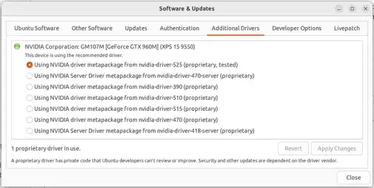

The problem seems to be related to NVIDIA graphics hardware (https://www.youtube.com/watch?v=_36yNWw_07g)
Solved the slow unlock time on my laptop by time by switching to the proprietary nvidia driver (search for "Additional Drivers" in Ubuntu): Additional Drivers in Ubuntu 22.04
