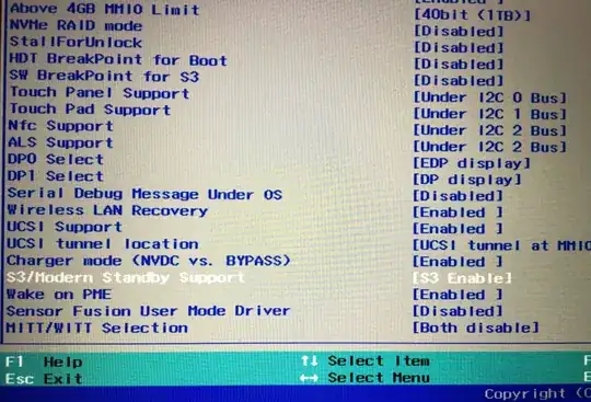

The suspend does not work properly because of poor s2idle support. If you have BIOS 1.04 on your SF314-42, you can enable back s3 support in BIOS. For this, you will need to get into the advanced mode.
David Watson summarized the instructions as follows:
I can confirm that the workaround reported here works on Acer Swift 3 with matching 1.04 BIOS and Ryzen 4700U. The key sequence required from the YouTube video to enable advanced bios is:
Boot into bios with the F2 key at the Acer screen. Once in BIOS, power off by holding down the power key. Once powered off, press:
F4, 4, R, F, V
F5, 5, T, G, B
F6, 6, Y, H, N
Power back on with the power key. Press F2 to enter BIOS. Now you are in advanced BIOS and there are hundreds of menu items. Go to AMD PBS. Scroll down to S3/Modern Standby Support. Select S3 Enable with the F5/F6 keys. F10 to Save and Exit.
After doing this process, the suspend function works reliably for me on Fedora 34 Beta Desktop. Suspend would hang as described here on just about every Linux kernel I tested prior to this including: Ubuntu, Manjaro, Clear, etc. I'm going to test Ubuntu 21.04 next and I'll report what I find.
