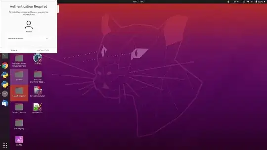

I am using Ubuntu 20.04(Gnome3.36) and need help with this:
Screenshot
The Authentication Required window is stuck right after logging in and I can't close it. I tried using xkill to close the window but it didn't close, I think xkill doesn't recognize the Authentication required window as a window.
I searched for answers but only found a reddit post which the author has the same problem, which is https://www.reddit.com/r/gnome/comments/fscvql/authentication_required_window/
Is there any easier ways to remove it than rebooting?
