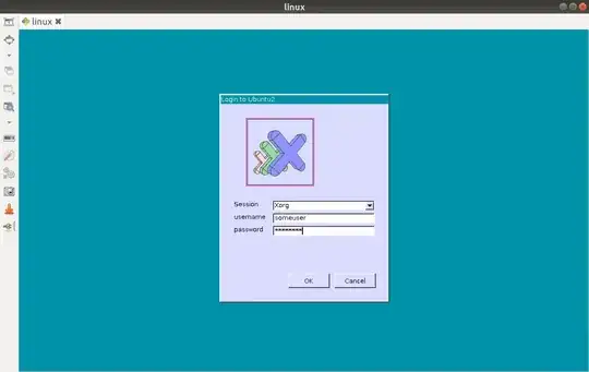

I've installed mate and xrdp on Ubuntu 18.04. Now I try to connect to this PC from another Ubuntu with Remmina:
I press OK, login window disappears background is same,nothing happens. My ~/.xsession contains mate-session.
xrdp.log contains stuff like this:
[20190818-12:23:09] [DEBUG] Closed socket 17 (AF_UNIX)
[20190818-12:23:12] [DEBUG] Closed socket 17 (AF_UNIX)
[20190818-12:23:15] [DEBUG] xrdp_wm_log_msg: connection problem, giving up
[20190818-12:23:15] [DEBUG] Closed socket 17 (AF_UNIX)
[20190818-12:23:15] [DEBUG] xrdp_wm_log_msg: some problem
[20190818-12:23:15] [DEBUG] xrdp_mm_module_cleanup
[20190818-12:23:15] [DEBUG] Closed socket 16 (AF_INET6 ::1 port 59402)
[20190818-12:24:11] [DEBUG] xrdp_wm_log_msg: connecting to sesman ip 127.0.0.1 port 3350
[20190818-12:24:11] [INFO ] xrdp_wm_log_msg: sesman connect ok
[20190818-12:24:11] [DEBUG] xrdp_wm_log_msg: sending login info to session manager, please wait...
[20190818-12:24:11] [DEBUG] return value from xrdp_mm_connect 0
[20190818-12:24:12] [INFO ] xrdp_wm_log_msg: login successful for display 10
[20190818-12:24:12] [DEBUG] xrdp_wm_log_msg: started connecting
[20190818-12:24:15] [DEBUG] Closed socket 17 (AF_UNIX)
[20190818-12:24:19] [DEBUG] Closed socket 17 (AF_UNIX)
[20190818-12:24:22] [DEBUG] Closed socket 17 (AF_UNIX)
[20190818-12:24:26] [DEBUG] Closed socket 17 (AF_UNIX)
[20190818-12:24:29] [DEBUG] Closed socket 17 (AF_UNIX)
[20190818-12:24:33] [DEBUG] Closed socket 17 (AF_UNIX)
[20190818-12:24:36] [DEBUG] Closed socket 17 (AF_UNIX)
[20190818-12:30:30] [INFO ] calling auth_start_session from pid 6502
[20190818-12:30:30] [DEBUG] Closed socket 7 (AF_INET6 ::1 port 3350)
[20190818-12:30:30] [DEBUG] Closed socket 8 (AF_INET6 ::1 port 3350)
[20190818-12:30:30] [INFO ] /usr/lib/xorg/Xorg :10 -auth .Xauthority -config xrdp/xorg.conf -noreset -nolisten tcp -logfile .xorgxrdp.%s.log
[20190818-12:30:40] [ERROR] X server for display 10 startup timeout
[20190818-12:30:40] [CORE ] waiting for window manager (pid 6503) to exit
[20190818-12:30:40] [ERROR] another Xserver might already be active on display 10 - see log
[20190818-12:30:40] [DEBUG] aborting connection...
[20190818-12:30:40] [CORE ] window manager (pid 6503) did exit, cleaning up session
[20190818-12:30:40] [INFO ] calling auth_stop_session and auth_end from pid 6502
[20190818-12:30:40] [DEBUG] cleanup_sockets:
[20190818-12:30:40] [DEBUG] cleanup_sockets: deleting /var/run/xrdp/sockdir/xrdp_chansrv_socket_10
[20190818-12:30:40] [DEBUG] cleanup_sockets: deleting /var/run/xrdp/sockdir/xrdpapi_10
[20190818-12:30:40] [DEBUG] cleanup_sockets: failed to delete /var/run/xrdp/sockdir/xrdpapi_10
[20190818-12:30:40] [INFO ] ++ terminated session:  username someuser, display :10.0, session_pid 6502, ip ::ffff:192.115.120.210:44136 - socket: 12
How do I fix or diagnose this brilliant piece of software?

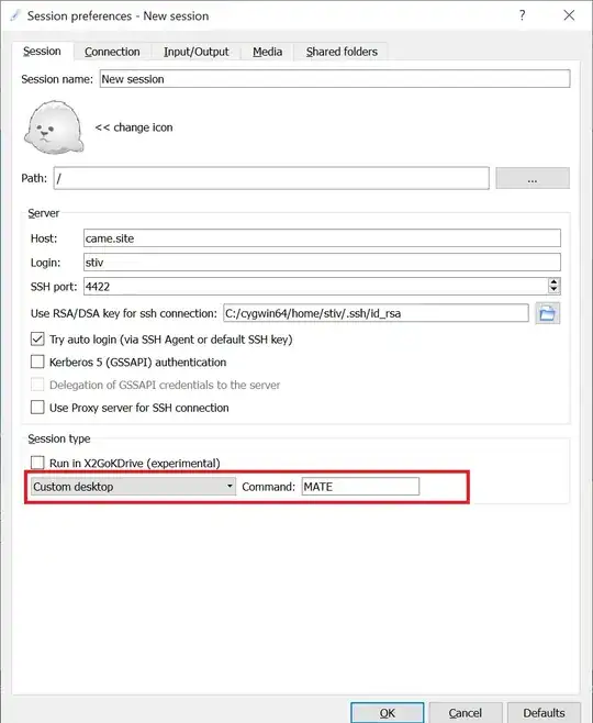

I have found an alternative solution:
apt-get install x2goserver
This will install x2go, which is opensource remote desktop server for Linux with x2goclient available both for Linux and Windows. Please note this software is way better then xrdp, but is also buggy. To use it, install for example mate desktop instead of linux default, default doesn't work with it yet:
sudo apt install tasksel
sudo tasksel install ubuntu-mate-desktop
When you create a connection with this windows client, you will need to set MATE desktop here:
It can work with some other desktops, but for default Ubuntu -- I was unable to make it work.
It has some bugs, which I can tolerate:
  • You might have issues with multiple keyboard layouts, to walk around this, you have to connect when EN layout is enabled on Windows, later you can switch to your national keyboard.
  • Clipboard is buggy and suddenly stops working. You solve it by reconnect.
  • Sometimes randomly it has keyboard glitches, but this doesn't happen very often, I can easily tolerate this.
  • If you use high DPI fonts on Windows, you may need to set this option to avoid your fonts look too big:
  • If you need it to connect automatically you will need ssh key, it can't store password. System is a bit buggy in that aspect, but I've found reliable solution: you install https://cygwin.com/, generate (ssh-keygen) and deploy (ssh-copy-id myself@myserver) key and then specify key in the connection settings (see pic above).
