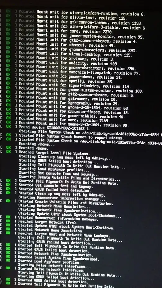

During one reboot, I was able to get some information by pressing F2 (I think), but I don't know if this is useful at all:
Any ideas as to what is causing the problem?? Help would be much appreciated.

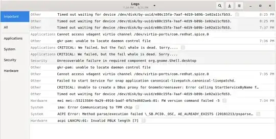

Update: Using the LXDE desktop environment, I opened the "Logs" application, thinking there might be some useful information. The first entry looks very similar to the error that showed up on my boot screen shown in the second picture. The expanded entry farther down also looks like it could be important: LXDE 'Logs'
Does this "timed out" error have something to do with my fstab file? And if so, why would that effect the login manager??
