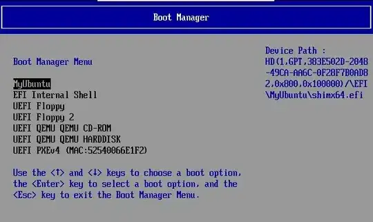

After I ran into systemd-boot as boot-loader I've never looked back at GRUB.
systemd-boot, is in my view, way more stable and has a much better way of configuration.
And by "stable" I mean it's not as vulnerable as GRUB. GRUB is so easy to break.
Just adding a new disk to your box can give you big trouble (because of maybe identical boot-loader ID's that you cannot change etc.)
Only downside of systemd-boot is the lack of secure-boot support, but that's not an issue for me, and that your kernel must be located in the EFI partition, instead of root partition, as it is the case with GRUP.
With systemd-boot I got back full control of the boot-process...YES
It should be the default boot-loader instead of GRUB.

General info:
bootctl will install two bootloader-files in your EFI partition:
../BOOT/BOOTX64.EFI
../systemd/systemd-bootx64.efi
These files are identical. Your EFI bios on your motherboard moust boot/point to one of them. Either do it in the BIOS directly or use the Linux command efibootmgr....
To add a new boot entries just create a new /mnt/efi/loader/entries/*.conf files which point to the right kernel files and root partition.
The kernel files MUST be located on the EFI partition (FAT32).
The EFI partition must be sized accordingly. I think the kernel files for e.g. Debian/Ubuntu is about 50-60MB. So if you have two installations you need 120MB.
grub-installe.g.boot from Archlinux live.iso. Maybe thebootloadèr-idwill not be hardcoded into the .efi file.And if so, will Ubuntu boot at all? – MrCalvin Mar 31 '19 at 12:37grub-installfrom Debian buster and my bootloader-id is nowubuntu2I could imaging secure-boot might not work. It seems whole reason for Ubuntu hardcode the ID is the bootloader in signed and therefore cannot be modified, well you can, but then it would not be signed anymore. . But I don't use secure boot any way so I don't care. – MrCalvin Mar 31 '19 at 14:34shimx64.efi. My entries point togrubx64.efi(I don't use secure boot too). – mook765 Apr 21 '19 at 11:15
