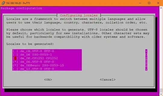

From my understanding, all locales which were recognized and enabled by dpkg-reconfigure locales have been kept and my custom locale is not listed there.
I guess that app provides all locales from the file /usr/share/i18n/SUPPORTED? Do I need to add my custom locale there manually as well? Something like the following doesn't seem to work, the new line is not shown:
de_DE.CP1252 CP1252
de_DE.UTF-8 UTF-8
