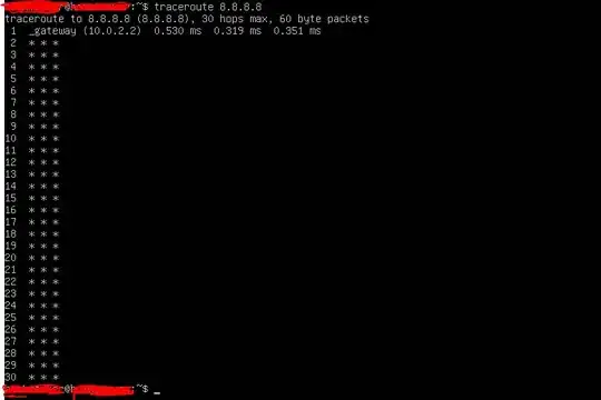

This is what I get when using traceroute 8.8.8.8:
traceroute screenshot

  • As workaround, you can try traceroute 8.8.8.8 to see the chain of IP addresses that leads to Internet. Then you can mach the first IP to the list of network interface. provided by ifconfig. – pa4080 Dec 17 '18 at 19:52

  • this is what i get on using traceroute 8.8.8.8 [https://imgur.com/a/2fclCay] – spamman Dec 17 '18 at 20:10
