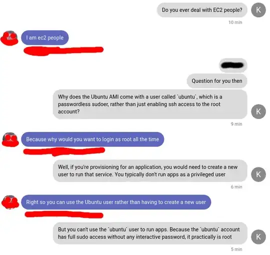

I chatted with one of my friends who works on the EC2 team, and he gave me a really good explanation.
The main difference to be discussed here is between a user who can run sudo without a password and can gain all privileges with sudo (passwordless sudoer), and the root user itself. My initial thought was that these two users are essentially the same, but as my friend explains, compromising the passwordless sudoer is inherently harder than the root user, if the attack vector is through an application.
The reason for the additional difficulty is that to gain sudo privilieges as a sudoer, you need shell access. Without the shell, an application running as the passwordless sudoer is essentially just a normal user. However, this means that if the passwordless sudoer were running an application that can execute shell commands on behalf of the user (i.e. Jenkins or some other CI tool), then the system could still be compromised.
It's still probably safest to run applications as a non-sudoer, but for most cases, I imagine that the passwordless sudoer is safe enough.
Full context of the discussion:
