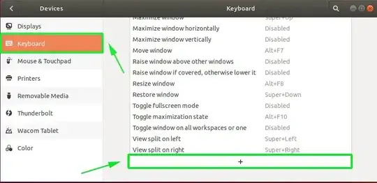

If you need or want to replace the PrtScr shortcut do the following:
  1. Release the PrtScr binding by this command
    gsettings set org.gnome.settings-daemon.plugins.media-keys screenshot '[]'
  2. Go to Settings -> Devices -> Keyboard and scroll to the end. Press + and you will create custom shortcut.
    custom shortcuts in ubuntu 18.04

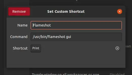

  3. Enter name: "flameshot", command: /usr/bin/flameshot gui or /snap/bin/flameshot.
  4. Set shortcut to PrtScr (print).
That is it. Next time you push PrtScr flameshot will be launched.

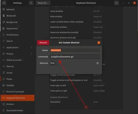

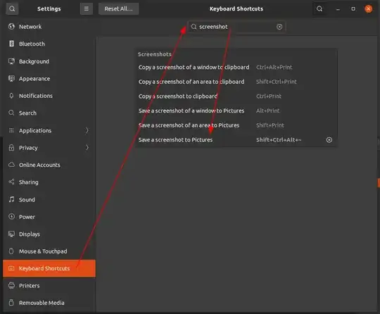

In case you installed Flameshot via snapcraft.io and not via standard sudo apt install flameshot, then the path /usr/bin/flameshot gui will not work, because the path is different.
  1. So, first run command type flameshot (for Ubuntu 18.04 and higher). This will show you the path where app is installed.
  2. Copy this path.
  3. Press Super and search for keyboard shortcut.
  4. Find word screenshot
    see this example
  5. Edit it (in my case, I assigned Shift+Ctrl+Alt+~ as I have never used this key combo)
  6. Then go back, click + symbol and add the path you have copied to command.
    and see this example

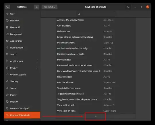

This is tested on Ubuntu 20.04

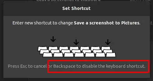

  1. Disable PrtScr or Print shortcut by opening the Keyboard Shortcuts Settings
  2. Navigate to Keyboard Shortcuts on bottom left menu, then select Print shortcut which is to Save a screenshot to Pictures
    keyboard shortcuts dialog
  3. Hit Backspace to disable the current keyboard shortcut so that we can use this for Flameshot later.
  4. Hit Set to apply/confirm it.
  5. Identify Flame binary location with which command
    $ which flameshot
    /usr/bin/flameshot
  6. Then, scroll down to the bottom and select + symbol to add new shortcut.
  7. Add Custom Shortcut
    • Name: Flameshot
    • Command: /usr/bin/flameshot gui
    • Shortcut: Print
That's it

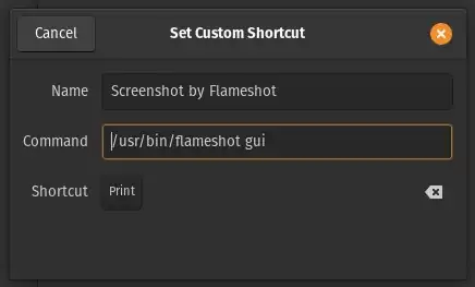

abeciaj
  • 56

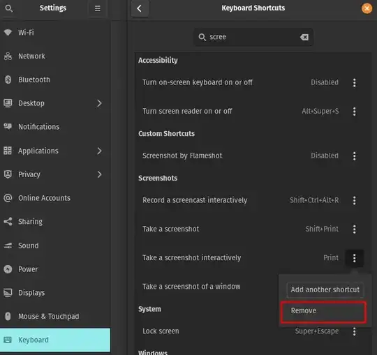

Steps worked on Pop!_OS 22.04.
  1. Go to Settings -> Keyboard -> Keyboard Shortcuts -> View and Customize shortcuts.
  2. Search 'screenshot' and remove the 'Take a screenshot interactively'.
    Configuration
  3. In the same window, search for Custom shortcuts -> Add (+ icon) -> Set this configuration:
Screenshot by Flameshot /usr/bin/flameshot GUI Print (or the key you want to configure)

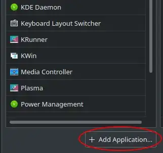

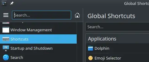

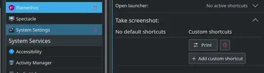

Working in Kubuntu 20.10 :
Go to System Settings
SystemSettings
Shortcuts > Global shortcuts
Settings_shotcut
click Add Application button (you can type "flameshot" on the search box)
addAplication
click OK
After adding the application, you should see a tab with Take screenshot description.
link PrtScr key to shortcut
Click on it, and press the PrtSc key on your keyboard to set the shortcut.
Enjoy :)
