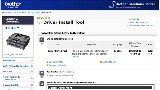

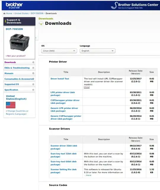

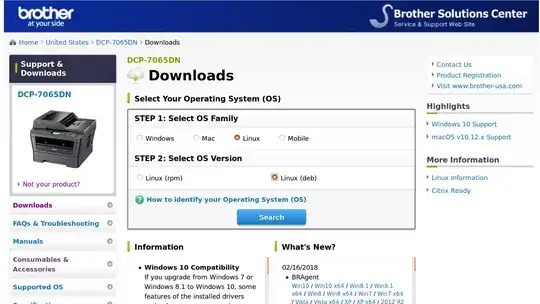

Brother seems to have removed the linux o/s config instructions from its support pages - i.e. here and here, which had been the source of earlier solutions to this problem given here and here. The OS support information page in its FAQS and Troubleshooting section refer only to Windows and Macintosh. If you look elsewhere, you will find a page of linux information. It says "The Brother Linux scanner driver works only with a superuser by default". It points to a page where it says is given the means to make the scanner work for non-sudo users - perhaps, then, SimpleScan. That page contains fix downloads for numerous OSs, but nothing later than Ubuntu 13.10. Downloading and installing that file all the same does nothing to make the scanner work. If you grub around long enough you will find there is a linux troubleshooting FAQ after all - just not in the place where you would expect to find it. Getting this Brother scanner to work is like threading a needle in a wind tunnel. The first item on the linux FAQ is 'I'm using Ubuntu 16.10. I cannot scan from my Brother Machine'. That is close enough. It says 'Install libusb-0.1-4'. (The Brother driver had dependencies but it did not bother to check them). I do have this usb lib installed already anyway.
