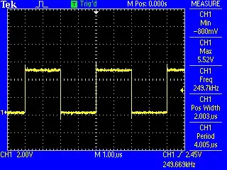

My requirement of 125 kHz is satisfied, but I am just curious to know why the sketch not working as it should.
According to my measurements, it is. Using this slightly modified version of your code:
// A sketch that creates an 8 MHz, 50% duty cycle PWM and a 250 kHz,
// 6-bit resolution PWM with varying duty cycle (changes every 5 µs
// or about every period.
#include <avr/io.h>
#include <util/delay.h>
int main(void)
  pinMode(3, OUTPUT); // Output pin for OCR2B
  pinMode(5, OUTPUT); // Output pin for OCR0B
  // Set up the 250 kHz output
  TCCR2A = bit(COM2A1) | bit(COM2B1) | bit(WGM21) | bit(WGM20);
  TCCR2B = bit(WGM22) | bit(CS20);
  OCR2A = 63;
  OCR2B = 31;
  // Set up the 8 MHz output
  TCCR0A = bit(COM0A1) | bit(COM0B1) | bit(WGM01) | bit(WGM00);
  TCCR0B = bit(WGM02) | bit(CS00);
  OCR0A = 1;
  OCR0B = 0;
I get the predicted 8 MHz output on pin 5:
8 MHz scope output
And the 250 kHz output on pin 3:
250 kHz scope output

  • The CRO considers a period to be made up of both high and low signal. - indeed. The original code had such a short pulse that a scope might have interpreted each pulse as half a period, and thus halved the reported frequency. It might have missed the very short on cycle, which is why I adjusted the duty cycle up to 50%. – Nick Gammon Aug 05 '15 at 10:06
