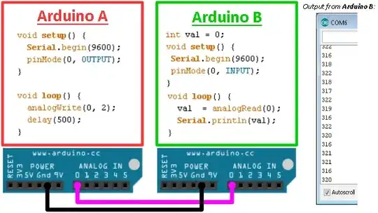

What I want to do is allow Arduino A to send some constant value to Arduino B.
I sense something inherently wrong with my approach, but I cant figure out what it is.
So in the diagram below you will see Arduino A setting its Analog Pin 0 as OUTPUT and write a value 2 every 500ms. On Arduino B we have Analog Pin 0 set as INPUT to receive and print data to Serial. The GND pins of both Arduinos are also connected.
When this setup is executed, Arduino B is constantly receiving data in the form of a 3 digit number starting with 3XX. I am starting to believe this is voltage value?
What is inherently wrong with this idea?

Arduino analog pins are ONLY for analog input, not for analog output.
So trying to do analog out on an analog pin dooms your attempt to failure.
Arduino analogWrite(pin, value) only works on DIGITAL pins and then only on the subset of digital pins that have PWM capability. This is typically digital pins 3 5 6 9 10 11.

analogWrite() on the Uno doesn't actually output an analog value. It outputs a PWM wave whose average is equivalent to that value. If you want to turn it into a true analog value then you need to put it through a low-pass filter in order to remove the components that make it a PWM wave instead.

The Analog In does exactly what it says - it only reads (samples) analog voltage levels.
Using AnalogWrite(0,2) does not make pin A0 in Analog In to output the voltage of 2*AVCC/1024, but instead makes the pin D0 to do that instead. (Most D0 pins on Arduino boards do not have a PWM output associated with them, so the behaviour would be undefined.) In the mean time, your A0 is doing nothing. (I suspect it's floating / not connected, hence the 3xx value. Could check the datasheet to be sure.)
So what should we do instead? For a start, connect Arduino B's A0 to Arduino A's pwm pin. If you're using Uno, you can connect to any of the pins 11,10,9,6,5,3. Then you can use the code:
int PWMPin = 11; int SignalLvl = 2; analogWrite(PWMPin,SignalLvl);
Give that a try. And you'll see that it works... sort of.
But then there's a problem. your readings will be close to what you want, but quite erratic. The reason is partly because analog signals are super unreliable and is filled with noise. But the main reason is really that Arduino's analogWrite is actually NOT designed as an analog signal output. It is a PWM, which outputs GND and AVcc levels at variable periods at a fast speed so that it approximates the voltage level you want when averaged.
