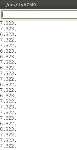

I have a pair of potentiometers, on the Arduino, the output seems to drift, by one or 2 digits, back and forth. I would prefer they were read as one fixed value, without variation when their knobs are not turning. You can see in the image, the first and second values are shifting back and forth slightly. How should I address this?
I'm thinking of making a standard deviation function, but then I thought that might be unnecessarily complex.
wandering pots
My code is that the 2 sensor values are setting points in an SVG polyline. Variance means extra points will get plotted, while the device waits for valid input.
How should I deal with the variance in potentiometer readings to avoid outputting noise?

    That's quantisation noise and is normal. You can't get rid of it, only deal with it. You could take an average, or you could discard some resolution, or you could write your code to work in a range of values not one single value. – Majenko Jul 31 '21 at 22:30
    Thats not drifting, just electrical noise in the analog input. You cannot really avoid that. But since your code isn't time critical, why not measuring multiple times, a erafing the values and then using the result. That would drastically reduce the noise in the used values – chrisl Jul 31 '21 at 22:34
    so Ill have to write some code to deal with it. I'm currently looking at calculating variance, standard deviation, normalization, and some other math terms I'm not exactly familiar with. I think I can make a simple statement to ignore values +/-1 of the read values, but im not sure what to do if the variance where any more than that. – j0h Jul 31 '21 at 22:59

ok, once I got the idea I would need to do it in code, it became simpler to solve. In looking around the terms of quantization, the term thresh-holding came up, and I realized how to solve the problem.
I created a threshold value, and compared the difference between old and new variables.
int threshold =3;
int xVariance = abs(sensorValX-oldX);
int yVariance = abs(sensorValY-oldY);
if (xVariance >=threshold && yVariance >= threshold ||xVariance >=threshold || yVariance >=threshold){
  Serial.print(sensorValX);
  Serial.print(",");
  Serial.print(sensorValY);
  Serial.print(",");
 oldX=sensorValX;
 oldY=sensorValY;
}else{ ; //dont do shi. // Serial.println(delbutton); delay(1000); }
now, when I turn either potentiometer, I get a response, and output I desire, but not while the device is just sitting there.

    Note, that you can leave out the xVariance >=threshold && yVariance >= threshold part in your if statement. It is redundant. The OR operator || will also evaluate to true, if both conditions are met. – chrisl Aug 01 '21 at 08:34
    This approach introduces hysteresis, which is indeed a common and effective approach against this kind of problems. – Edgar Bonet Aug 01 '21 at 15:31
  • @chrisl, is it redundant? in the event one or both potentiometers are +/- threshold value? one value may change, while the other is constant, or both may change. – j0h Aug 01 '21 at 21:35
    Yes, it is redundant. The OR operator || also evaluates to true, if both operants are true. You can refer to the truth table of that operator. What you were thinking of is called exclusive OR, or shortly XOR. – chrisl Aug 01 '21 at 21:58

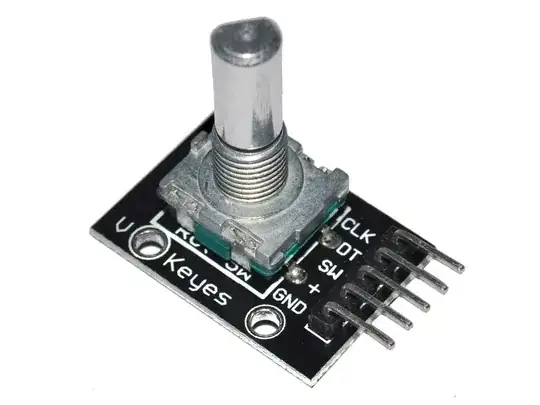

Remove the analog component from your device.
Use a rotary encoder.
It will sense the knob rotation digitally.
One huge advantage is that you can easily select the sensitivity of the input. One click can advance the counter by .001 just as easily as advancing by a 1000.

  • you're not wrong, once I get this project functionally operable, its going to a children's museum, and you cant have knobs with limits, they break when you get 1000 kids a week cramming them all the way to one side or the other. but I still have some work to do, and I don't have the encoders yet. – j0h Aug 01 '21 at 00:49
    @j0h then you may be interested in this ... uses a stepping motor as an encoder ... it makes a tough encoder ... https://create.arduino.cc/projecthub/andrewf1/using-stepper-motor-as-rotary-encoder-3f5de4 – jsotola Aug 01 '21 at 01:17
  • Right on! @jsotola I saw some things like this while working in a paper mill, but forgot all about it. I'm definitely going to look into this more, as steeper motors are harder to break than tiny little knobs. – j0h Aug 01 '21 at 15:58
Some methods for "dealing" with the noise:
  1. Take multiple samples. Calculate the average ("mean"). Discard the decimal. This is "oversampling" along with resolution reduction (but reduction of the now increased oversampled resolution).
  2. Take multiple samples. Find the most common value ("mode").
  3. Divide the value by 2 (or 4 if needed). This reduces the range of values and the sampled resolution but discards the noise portion.
The problem you are suffering from is "quantisation noise". This is because an analog signal and a digital signal are not completely compatible. The ADC converts the analog signal into a digital value by successively comparing it to smaller and smaller voltages in steps ("quanta"). There is a limit to how small the steps can get (the resolution), but an analog voltage doesn't adhere to those steps, it will always be somewhere between the final two steps. Sometimes it will be detected as the lower step, sometimes the upper step. By taking multiple samples and averaging them you are estimating how close to one step or the other the value is and "refining" the result. This is "oversampling" and is used to increase the resolution of the ADC at the cost of sample speed.
With those extra samples you can either say "It's this much closer to the upper step" (take the "mean"), or say "It's more likely to be nearer the upper step" (take the "mode") to try and "fix" the value to one of the steps.
Majenko
  • 105,095
  • 79
  • 137
  • I appreciate the new words, and concepts, I will look into these methods further. I was concerned that calculating standard deviation on the Arduino may reduce performance, by being computationally intensive. – j0h Aug 01 '21 at 16:07
