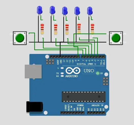

    Here is the Arduino simulation output for your code and the code suggested by @cat
below is after adapting the solution from cat enter image description here
The simulation links are here: Original problem solution 1

Link to docs on Pushbuttons. Wokwi Arduino simulator simulates debounce by default - just like real-world switched. Debounce is a very important technique that you should consider adding to the code. To disable the "bounce" option, use the below trick!
{ "bounce": "0" }
