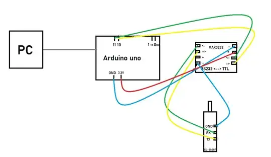

And the current schematic (sorry for my drawing skills)

Hi and welcome to the wonderful world of Arduino. It appears that you have picked-up Arduino with ease. Your program is almost there. Your wiring connection diagram looks to be correct.

  • Thank you so much for your effort to explain this all. But as said earlier in the other post, there is totally no data coming in. Maybe there is something wrong with the MAX3232. With debugging (add println's in if-statements), there is also no result. Only when I disconnected and connect the GND again I get data from the mySerial.available() if statement. – Joost Jun 02 '21 at 07:28
  • Which GND are you referring to? – sa_leinad Jun 02 '21 at 14:49
    It's working for now. I've disconnected the MAX3232 chip and connected the RS232 device directly to the Arduino. I know, it's not a best practice, but it is low voltage. – Joost Jun 03 '21 at 09:10
