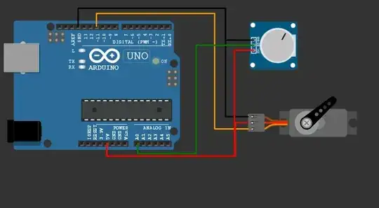

Here are the simulation results of the code from Chrisl enter image description here
The code (same as the other answer)

You can tweak the code and see the changes online- Link to the arduino simulation
