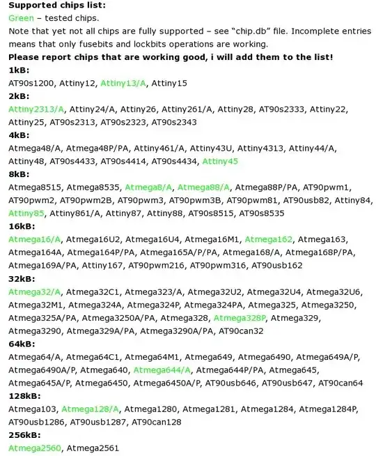

I think µProg – tiny, fast, portable AVR programmer with SD does what you want. You can store multiple files in the SD card (hex, eep etc) and select from the device menu which one to write to the target MCU without any need for a PC.
The best part is that it's available for free (PCB, schematic, firmware etc).
One of a kind, portable AVR programmer! Helps wherever you need to update the device firmware, where target device is in a hard-to-reach location and you can’t (or don’t want to) bring your laptop with a bunch of wires with you. Trivially easy to use, super cheap to make, super small, super fast, uses SD cards…
Features:
  • super small – dimensions 44 x 39 x 5,5 mm
  • super fast – write up to 12,5kB/s, read up to 14,5kB/s
  • uses cheap storage medium – small MICRO SD cards
  • supports FAT16 and FAT32 file systems
  • can read, write, verify flash and eeprom memory
  • can read, write, verify fusebits and lockbits
  • write and read to BIN, HEX, and TXT files
  • can set default values of fusebits, erase memories
  • cheap, easy to obtain, LPH7779 graphic display
  • shows funny animations after every operation
  • standard programming header – Atmel 6-PIN ISP
  • has a function of auto-update its own firmware (from SD)
  • very simple to use, 4 buttons navigation
  • user-setting menu
  • programming speed auto-selection (up to 4MHz)
  • Operates at 3V, programs chips supplied from 3V to 5V
Supported chip list
