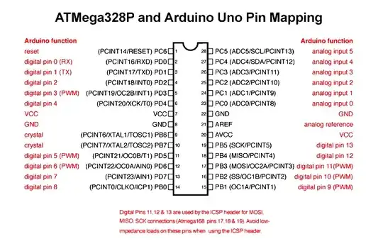

  • Which pins are which on the Arduino board and the ATmega328P?

Yes it's possible. To use the ATmega328P to "emulate" an Arduino Uno board (without the USB part) you just need 3 ou 4 additional components: the oscillator, two capacitors and a resistor. Please take a look at: https://www.arduino.cc/en/Tutorial/BuiltInExamples/ArduinoToBreadboard for a schematic/breadboard. The Atmega328P features itself the memory, cpu and flash so those components are already inside the chip. You can find the relation of the pins in this image: Pin matching
