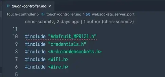

I'm using vscode for my editor and I've had this snag for a while but it's finally driving me nuts enough to ask for help.
When in include certain libraries I get error squiggles under the include.
squiggle
In this case the squiggle is popping up because of the error:
cannot open source file "WProgram.h" (dependency of "Adafruit_MPR121.h")C/C++(1696)
WProgram.h error

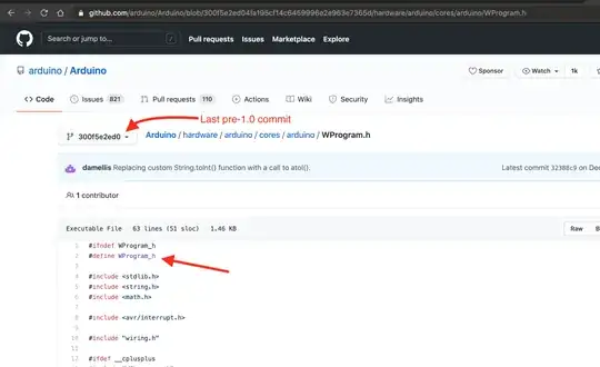

We know that the Arduino.h header for all intents and purposes is the same as the WProgram.h, so a almost-full-proof solution would be to fake out the WProgram.h file on my computer to appease the compiler.
Faking WProgram.h
An important part to note here is that to make sure I faked it out correctly I went to the arduino repository, scrolled back through the tags, found the last tag before they switched to 1.0+, and found the WProgram.h file. Once there I grabbed the same pre-compiler check and definition for the WProgram header so I could be sure I did the correct define for the WProgram name.
Correct WProgram define string
This feels like a bit of overkill because it protects me from other headers being included with the same string defined, but if that happened it would be because I have the WProgram file anyway, but I figured if I was going to fake it out I'd do it right.
