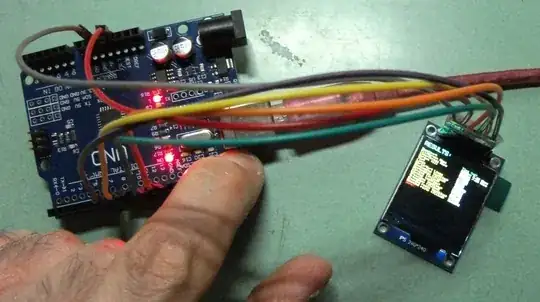

I am trying to get the ST7789 TFT display to work with Arduino. I followed online guides for connections and am using the fast library fron github and included workbench ino (https://github.com/cbm80amiga/Arduino_ST7789_Fast). Problem: The program runs and drives the display but the image is corrupt and only partial. I discovered that if I quickly and firmly press the reset button - and keep it pressed down - the image at the moment of reset press suddenly becomes full and good (albeit static because reset is pressed). Ofcourse as soon as I release the reset button the program restarts with the same corrupt image (the pictures below illustrate the issue).
This is the final screen of the demo showing the corrupt image This is what happens when I press and hold the reset button - the image suddenly becomes nice!

  • Maybe that "fast" library is just too fast? Have you tried the Adafruit ST7789 library? We know that one works properly. – Majenko Oct 25 '20 at 20:36
  • Did your program constantly clear the screen (with fillScreen()) in a loop? – hcheung Oct 26 '20 at 07:14
  • As different UNOs as well as different displays show the same behaviour, it's the software, most probably. Did you try what Majenko suggests? – the busybee Oct 26 '20 at 07:26
  • Regarding fillscreen, no. In the besnchmark test shown fillscreen is used to clear the screen inbetween benchmark tests. The setup function ploughs through each test. At the end is prints the results to the screen and leaves it like that. The loop function is empty. So you are left with a static screen of results (shown in my pictures above). The corruption is constant throughout regardless of animation, clearing screen or static images. Only press-holding the rest make the image full and clear. Perhaps something to do with grounding / changing constant voltages somewhere caused by the reset? – WildCat Oct 26 '20 at 09:16
    I managed to load an example that uses the standard Adafruit libraries (not the fast libraries) - from here link. It 'works' but with the same problem described above - corrupt image until press-hold of reset then image becomes full and clear. So not a problem with the 'fast' library. – WildCat Oct 26 '20 at 15:21

I found the answer to this problem. After reading multiple web pages / YouTube videos from multiple authors on this device and ~all of them warning you must never connect the Vcc to 5v or it will destroy the display, I found one or two that suggested you could use 5v because in this particular module there is a built-in regulator. So, faced with the thing being useless anyway, I decided to take the plunge and connect the Vcc of the TFT to the 5v pin of the Arduino and - hey presto - it works perfectly (see picture below: note the clear full image without the reset button being held down and also notice the voltage pin of the TFT is now connected to Arduino 5v compared to the pictures in my question). enter image description here
The picture below shows the back of my TFT display module and, from what I have read, it is the J3Y transistor that is key to the voltage regulation in this module. enter image description here
I hypothesise that pressing the reset button must have allowed equalisation of the voltages somehow but it is beyond my knowledge to explain it. I tried measuring the 3.3v pin on the Arduino with a voltmeter while holding down the reset button but I could see no change (the TFT module was not in situ for this test so maybe there is some interaction between Arduino and the TFT circuitry during reset).
Please note: I suspect this is a peculiarity of the particular TFT display module I have. Please DON'T run your 3.3v devices at 5v unless you have good reason to believe that they can take it. I only tried this after reading a couple of pages (including the detailed specs on the TFT module seller's listing) that suggested it would be OK with my particular TFT module - your's may be different. But if you have the same problem you see in my question then maybe that is something to consider. Thanks to those who have responded.
