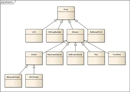

Majenko's answer is the right answer for your question. But to answer the title of the question, if you ever need to use different Arduino outputs and inputs as variable, most of them have common type Stream or Print. So it would be:
Stream& SensorSerial = Serial;
or
Stream* SensorSerial;
SensorSerial = &Serial;
The Arduino Stream classes hierachy:

    Gave the answer to the other person because it fit more precisely what I meant. But this is really helpful to know for another part of the same project – metichi Oct 19 '20 at 22:06
    This is actually how libraries do it and I consider it superior to the preprocessor solution. – AndreKR Oct 20 '20 at 09:36
    More importantly this can be leveraged at run time to switch between &Serial, &Serial2 etc. Macros are OK for compile time. – mckenzm Oct 20 '20 at 21:27
  • this should be the accepted answer. – Alnitak Oct 21 '20 at 07:01
