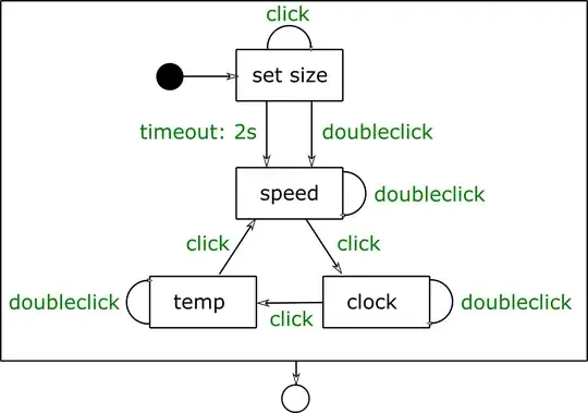

What you likely need is a state machine. The behavior of the actions depends on the state the program is currently in.
In your case, the state machine might look like this:
State machine
What does it mean?
  • black circle: this is where the system powers on
  • rectangle: a state
  • arrow: a transition from one state to another
  • green text: action
For the problematic double click action, you can see:
  • it changes the state from "set size" to "speed"
  • in all other cases, it does not change the state (actually it changes the state to the same state)
I always recommend drawing the state machine before implementing it. It makes mistakes much more obvious.
There are several ways to implement it. The easiest one being a switch/case. More advanced implementations may use object orientation. When using switch/case, I prefer to have one method per state, like so:

jsotola wrote a very important term in the comments: state.
You should implement your project as a Finite State Machine (FSM), a very important and powerful, yet easy principle. You divide your program into different states. Each state contains code, that only gets executed, when the program is in this state. Depending on input events (like the user pressing the button), you do transitions between the states.
I already wrote a rather detailed answer about FSMs for this question. You can read it to get a better understanding of FSMs.
For your case I would suggest these states: INPUT_SIZE, DISPLAY_SPEED, DISPLAY_CLOCK and DISPLAY_TEMPERATURE. INPUT_SIZE is the initial state (which you might skip after the first power on, after you saved the size in persistent memory like EEPROM). There you execute your current button code. When you sense a double tap on the button, you change to the DISPLAY_SPEED state. From there on a button press to the DISPLAY_CLOCK state and so on.
