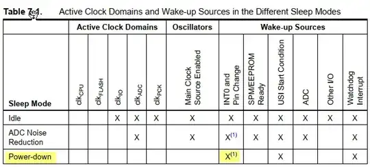

    Instead of attachInterrupt(), the interrupt service routine (ISR) for the necessary vectors are hooked directly, e.g. ISR (PCINT0_vect) { .. }. An example with attachInterrupt is in the first post with the code labeled Waking from sleep with a signal, which matches your button better. When an interrupt is configured for a pin, a change event will automatically wake the CPU from sleep. See datasheet (http://www.farnell.com/datasheets/1698186.pdf) section 7.1 "Sleep Modes", "INT0 and pin change" – Maximilian Gerhardt Nov 18 '19 at 21:55

ATTINY's are designed to easily do this since they can wake from power down sleep mode by a pin change...
Basically you want to...
  1. Connect a normally-open push button between an IO pin and ground.
  2. Enable the pull-up on the IO.
  3. Enable the pin change interrupt on the IO pin.
  4. Enable interrupts.
  5. Enter "power down" sleep mode.
When the button is pushed, it will connect the IO pin to ground, which will cause a pin change interrupt, which will wake the chip from sleep.
Note that you do not need to do anything in the pin change ISR (you can use the EMPTY_INTERRUPT compiler macro). If the ISR is empty, execution will pick up on the line after the sleep upon waking.
While in deep sleep, the chip will use an astonishingly small amount of power. For example, an ATTINY25/45/85 running off of a 3V coin cell at room temp will use less than 0.2uA...
