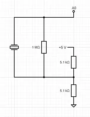

For the vibrations, a piezo sensor is used. Because it can produce a signal in two directions, I decided to use a voltage divider to offset the signal from GND. Two 5.1K resistors are connected from the piezo negative terminal to 5V and GND. A 1M resistor is placed in parallel with the piezo sensor. The positive terminal is connector to analog input 0.
Piezo circuit

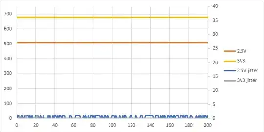

edit 29-10 17:53 Added better plots
edit 30-10 17:53 Added plots for 2.5V and 3.3V lines

  • @PeterPaulKiefer Sorry I don't have a oscilloscoop to check. I'm using the default analogread, I haven't changed the reference settings. Wire to piezo is roughly 75 cm and shielded, shield is not connected to GND at the moment. Strange thing is that the whole set-up is exactly the same for both plots but when powering the arduino with 9V I get the huge jitter issue. I've added a schematic for the piezo. – YouKnowNothingJohn Oct 29 '19 at 17:12

  • Peter, not a problem, you have been very helpful so far! I now get what you mean with supplying Vref with Vcc. I did some tests on the voltages, I connected 5V to A1 and 3.3V to A2 and did the same measurements. I took 100 samples and show twice the amplitude (difference between min and max values). USB https://imgur.com/rmhgnRB 9V https://imgur.com/MQEMvc9. I think a potential solution might be to use the 3.3V from the datalogging shield as it looks to be very stable! Although strangely, the 5V plots don't show a huge difference between the two power sources... – YouKnowNothingJohn Oct 30 '19 at 11:35
  • Actually, I have done the plots again and they now look like this. USB: https://imgur.com/ImOdHyC. 9V: https://imgur.com/JWyaxo2. I'm not sure where the difference comes from but these seem to make sense. So judging from these plots, I should have no issues running the piezo with the 5V via a voltage divider. I'll see if I can also measure the voltage after the divider. – YouKnowNothingJohn Oct 30 '19 at 12:57
    Here are some plots of the 2.5V line with and without piezo. USB with piezo: https://imgur.com/mIbWWd4. 9V with piezo: https://imgur.com/JoxX7BS. 9V without piezo: https://imgur.com/buD1Fc0. Strange... – YouKnowNothingJohn Oct 30 '19 at 13:20
