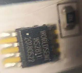

I have a 5 meter strip of 12V digital RGB LEDs. The chip is WS2811 (see photo of IC). There are 50 addresses on the strip.
WS2811 IC
Using the FastLED library, I am able to run the "FirstLight" example that chases full white with a single address at a time, up and down the length. That works fine. So I know they individually perform properly.
However, if I set all LEDs to full white (255), the first few addresses look white but then the higher the address, the more red it is. See photo below. The strip starts in the center of the reel.

I would suspect that it is a voltage drop in the power rails caused by the current draw. Probably cheap construction with copper tracks that are just too thin and so have too high a resistance.
To combat it you will need to inject power into the strip at various points along it. Initially to prove the theory you can try connecting the power to both ends of the strip and see if the "dull" spot is half way along the strip. If it is, then it's certainly a voltage drop. (incidentally, a voltage drop will cause the blue LEDs to fade out first making it go yellow-red. Then the green ones would probably be next, making it go red).
Then, once proved, you will need to add extra power connections into the strip at the middle of any dim sections and feed the voltage directly in at those points.

    You were right! I connected both ends and the middle was only slightly off-color. I thought that such a simple product couldn't possibly have this issue, and yet here it is. I've never seen such a dramatic drop on such a short strip before. – Bort Oct 28 '19 at 00:54

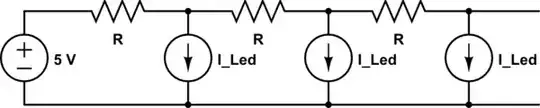

I then modeled the strip as a sequence of ideal current generators joined by resistors:
schematic
simulate this circuit – Schematic created using CircuitLab
Calling R the resistance introduced by the strip, I_Led the current flowing into one LED and N the number of LEDs turned on (and ignoring the effects of the standby current), the voltage drop on the first resistor is dV1 = RNI_Led, the one on the second is dV2 = R*(N-1)I_Led and so on, up to dVN = RI_Led. The total voltage drop is dV = RN(N+1)*I_Led/2.
Using the measured data, we can calculate the resistance between two consecutive LEDs:
R = (2*dV)/(N*(N+1)*I_Led) = (2*0.64V) / (100*101*0.018A) = 7mOhm
