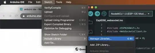

The proper way is to add library into your Arduino IDE, it will just work.
  1. Open the Arduino IDE
  2. Go to Sketch > Include Library > Manage Libraries
  3. Search for "WebSockets Sattler' and install the library named "WebSockets by Markus Sattler"
  4. Restart the Arduino IDE.
PS
  • you will see two results for WebSockets library from the same author
  • the second "WebSockets_Generic" is a more lightweight library and it only provides support for WebSockets in the client mode (it is designed to be more memory efficient)
