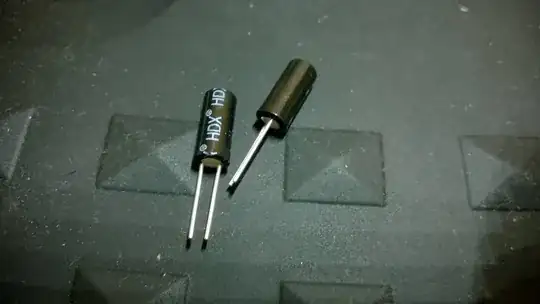

  1. Capacitor? -- Looks to be a capacitor, labeled HDX and nothing else, rattles when I shake it. Unknown part #1 - HDX capacitor?

  1. Those are tilt sensors. The rattling is a metal ball that contacts two pins inside, closing the connection.

  • Just did some tests with the parts and this answer is correct: #1 is a vibration sensor, it points up and cuts off current if it detects vibration. #2 is a phototransistor, works with flame but not light (unsure how this works in comparison to photoresistor, will have to do some research). For #3, I am leaning towards them meaning the single-digit 7-segment display, since there isn't anything else on the parts list that matches it, but unsure why they used 'control', I think maybe they just translated wrong or the vendor doesn't really understand what the component is. –  Dec 30 '14 at 07:44

Thanks for the heads up on the HDX switches. Now I know what they are.:)
Squidges
The HDX is a "Tilt Switch" Turns on/off depending on the angle.
