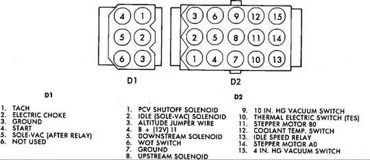

The vehicle is an AMC eagle, they come with a diagnostic port diagnostic port I have made a diagnostic tool that lights led lights when signals turn on and off, but it has to be wired in and is bulky. I am wondering if it would be possible to have an arduino plugged in and running off the 12v battery supply (with step-down to 5v) and have it catch the signals and send them over Bluetooth to a computer. Does this sound like it is within the scope of an arduino or am I asking too much? Or is there a better and easier way to do this? diagnostic tool I made

  • It is to answer a need, it would be a replacement for my homemade diagnostic tool that I built (picture added). These vehicles are finicky as older cars can be, and I would like to be able to provide a simple tool for me and others who want it to use, not unlike the small Bluetooth obd2 readers that have pop'd up. Arduino sounds like the best option but I wanted to ask before I went down the rabbit hole only to find out that there is already something that does pretty close to what I'm after. – Shane R. Jul 02 '19 at 17:36

  • I have a bunch of 2n222 smd parts but I doubt they could handle 12v, would I need to have one transistor per gpio used? The diagnostic port has 16 inputs that I would like to use. – Shane R. Jul 03 '19 at 02:26
  • Also, a lot of these signals are either always on, off, or change rarely. For example coolant temperature switch just goes from off (0v) to on (12v) when the coolant temperature reaches 135deg F. So speed is not that critical for most operations. Would an optocoupler work fast enough for these types of signals? My only concern is putting a bunch of resistors in a small package in a hot engine bay and having them constantly divide 12v would make the whole thing pretty hot. I could be wrong thou, I have a pretty basic understanding of electrics. – Shane R. Jul 03 '19 at 03:38
  • The current flow thru the transistors is very low, not much heat will be generated. P=IIR, so say you had a 10K and a 5Kin series to drop 12V down to 4V, then the current thru the pair would be I=V/R = 12/15000= 0.8mA, and P = 0.096W * 16 = 1.5W for 16 circuits. You could increase the resistor values and lower the generated power. Alternatively, you could use a pair of cd74HC4050 as level translaters, powered from 5V, to bring 12V down to 5V. 48 cents each at Digikey.com. That would use even less current for lower power dissipation as the output is just 1uA to drive the Arduino inputs. – CrossRoads Jul 03 '19 at 11:55
  • I like the cd74HC4050 idea, in looking at the spec sheet, are there 6 inputs per chip? So for instance I would plug 5v regulated into pin 1, arduino gpio X into pin 2 and input 1 into pin 3? I'm specifically looking at the cd74HC4050E if there are differences between the chips. If there are 6 "inputs" per chip I would need 3 correct? – Shane R. Jul 03 '19 at 13:00
  • Yes, 3 chips would provide 18 channels. I don't have the datasheet in front of me, but the pinout is straight forward. Don't forget to use a 0.1uF cap from 5V to Gnd, located near the chip. – CrossRoads Jul 03 '19 at 14:01
