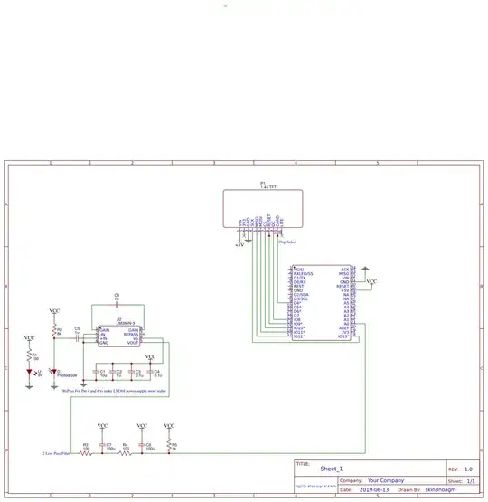

Lastly, I provided the schematic for more reasoning opinion and it was provided by Easyeda.com and you have to have an account to view my schematic
Things I have tried...
  • I have modified TFT pins since Gtting_BPM_to_Monitor uses Timer1 & Timer2
  • I have added/remove a lot of delays
  • I have insertednoInterrupts(); and interrupts();
Edit 1 : Here is a PNG of the schematic if and hopefully, it is clear enough. enter image description here
