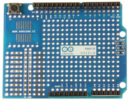

You can use Arduino proto shield. It's a prototyping board shaped the way it can be plugged into the Arduino. There are over 9000 of them from different manufacturers. Then just solder the stuff you need on the proto shield.
