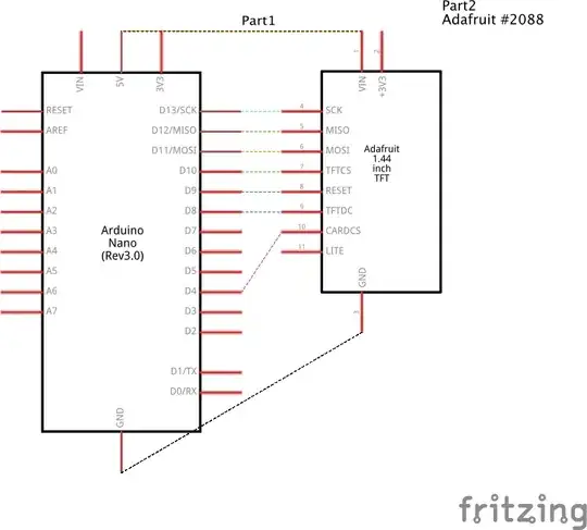

I just bought the 3rd TFT and in all my attempts I get the white screen I don't know what I'm doing wrong!
This time I bought it and followed their instruction's guide
I created this schematic using Fritzing which is the one I'm using but still I am getting the white screen again
Here are some Photos of what is the TFT displaying.

changes suggested:
  This is a library for several Adafruit displays based on ST77* drivers.
  Works with the Adafruit 1.8" TFT Breakout w/SD card
    ----> http://www.adafruit.com/products/358
  The 1.8" TFT shield
    ----> https://www.adafruit.com/product/802
  The 1.44" TFT breakout
    ----> https://www.adafruit.com/product/2088
  as well as Adafruit raw 1.8" TFT display
    ----> http://www.adafruit.com/products/618
  Check out the links above for our tutorials and wiring diagrams.
  These displays use SPI to communicate, 4 or 5 pins are required to
  interface (RST is optional).
  Adafruit invests time and resources providing this open source code,
  please support Adafruit and open-source hardware by purchasing
  products from Adafruit!
  Written by Limor Fried/Ladyada for Adafruit Industries.
  MIT license, all text above must be included in any redistribution
#include <Adafruit_GFX.h>    // Core graphics library
#include <Adafruit_ST7735.h> // Hardware-specific library for ST7735
#include <Adafruit_ST7789.h> // Hardware-specific library for ST7789
#include <SPI.h>
  #define TFT_CS        10
  #define TFT_RST        9 // Or set to -1 and connect to Arduino RESET pin
  #define TFT_DC         8
// OPTION 1 (recommended) is to use the HARDWARE SPI pins, which are unique
// to each board and not reassignable. For Arduino Uno: MOSI = pin 11 and
// SCLK = pin 13. This is the fastest mode of operation and is required if
// using the breakout board's microSD card.
// For 1.44" and 1.8" TFT with ST7735 (including HalloWing) use:
//Adafruit_ST7735 tft = Adafruit_ST7735(TFT_CS, TFT_DC, TFT_RST);
// For 1.54" TFT with ST7789:
//Adafruit_ST7789 tft = Adafruit_ST7789(TFT_CS, TFT_DC, TFT_RST);
// OPTION 2 lets you interface the display using ANY TWO or THREE PINS,
// tradeoff being that performance is not as fast as hardware SPI above.
#define TFT_MOSI 11  // Data out
#define TFT_SCLK 13  // Clock out
Adafruit_ST7735 tft = Adafruit_ST7735(TFT_CS, TFT_DC, TFT_MOSI, TFT_SCLK, TFT_RST);
Replace your that part with one I suggested as You commented tha SCK and MISO pins in your code so no data transfer is happening on those pins. Secondly I made changes according to your hardware configuration as well.
Vaibhav
  • 546
  • You are a genius ... haha No more stupid white screen ... I see a colorful screen – Noajm IsMy Name Jun 04 '19 at 12:31
