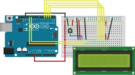

So I am following this tutorial to make my arduino display hello world and millis(), I got it to work for a minute, but then it stopped updating the milliseconds, and when I pushed the reset button it went blank. since then, It has been blank but I have double, triple, and qaudruple checked checked my wiring, and it is flawless. I tried it with both of my 16 segment displays, but to no avail. I have redone the wiring, but it is still blank. Does anybody know what I could be doing wrong?
I followed this diagram Fritzing diagram this is my code:

This is the result (the screen is lit up, but there is no text even when turning the potentiometer) Picture of the Arduino connected to the LCD display

  • that is not a 16 segment display .... this is http://www.embeddedadventures.com/images/uploaded_images/DSP_16S04H_2_600.jpg – jsotola Mar 18 '19 at 22:16
    Please do not post images of code, paste the code itself, select it all and then press {} to properly format it. Also this display is 16x2 character one, not a segment one. – Avamander Mar 18 '19 at 23:20

    I suspect that you wiggled a loose Dupont wire back to it's place. They're quite flimsy. In addition to that, please post your best theory as the answer and click on the check mark button to mark it as the correct answer, adding (SOLVED) to the title is not how Arduino SE works. – Avamander Mar 19 '19 at 02:43

  • Do any of you have an idea as to what may have been wrong? ..... perhaps the upload was failing and you did not see the error messages for some reason .... so you were re-running the same sketch over and over – jsotola Mar 19 '19 at 04:12
  • I rewrote the sketch twice, I think it had to do with hardware, if you look at my answer below – Asher Mar 19 '19 at 13:57
It is most likely that I wasn't providing enough power to the arduino, and or had the potentiometer set to the wrong point. according to this post, you shouldn't run the arduino and display off of USB, because it may not actually be providing 5 volts. So I plugged it into the wall using a DC adapter. It now works.
